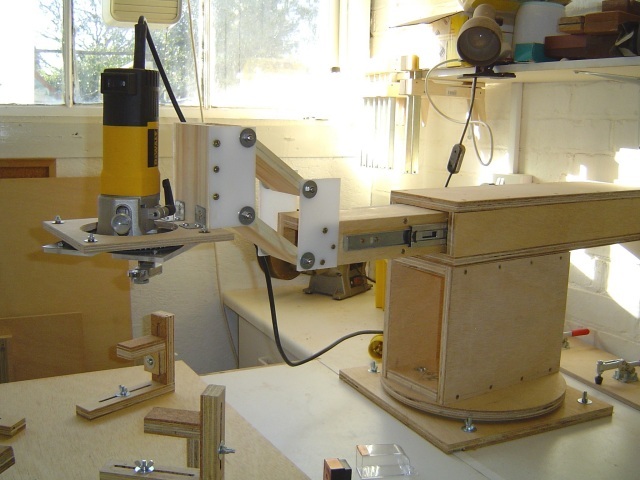

Jammy I use and like the DeWalt DW670 trimmer, I bought mine through Maxtool over here on line, but it is a US one, 110V, and was much cheaper than buying the same tool in the UK. All my hand power tools are 110V and run off a site transformer.
It does everything I want, and I especially like the solid construction, and of course the bearing guide.
